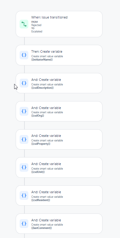

Issue A is in project 1
Issue B is in project 2
Whenever Issue A goes through a specific transition, I want to modify the description of Issue B with several information from Issue A. For the exercise let's say I want to add
  • IssueA.description
  • IssueA.lastComment
  • IssueA.customField1
  • IssueA.customField2

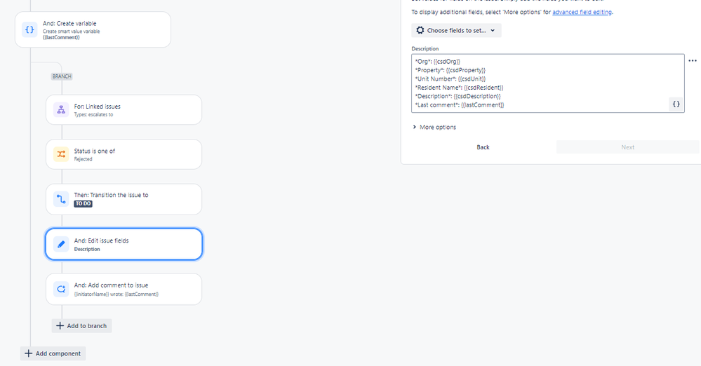

What I am currently doing is I have an automation setup that is triggered when Issue A goes through said transition, and then modify Issue B using a related issue branch. The problem is when I am in the branch, {{issue}} is actually referring to Issue B.
My current solution is to use variables for each part of IssueA that I want to translate to Issue B. I just wanted to know if I could simply take the entire {{issue}} object and assign it to a variable instead of each piece.
Here are some images of my automation
2024-05-23 08_56_29-Rule builder - Automation - Customer Service Desk - Jira.png2024-05-23 08_57_35-Rule builder - Automation - Customer Service Desk - Jira.png
