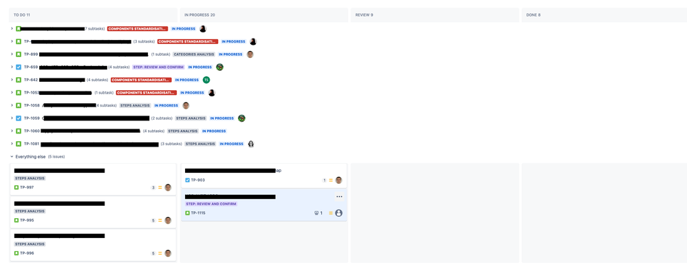

I currently have the board grouping by issues, but some issues/tasks, despite having subtasks, are not being represented as a group and rather showing up in the 'Everything else' group.
I can't discern any difference between what is being grouped by issue and what is in 'Everything else'.
What am I missing here?
Thanks in advance.
Screenshot 2024-11-05 at 11.29.20 AM.pngScreenshot 2024-11-05 at 11.39.14 AM.png

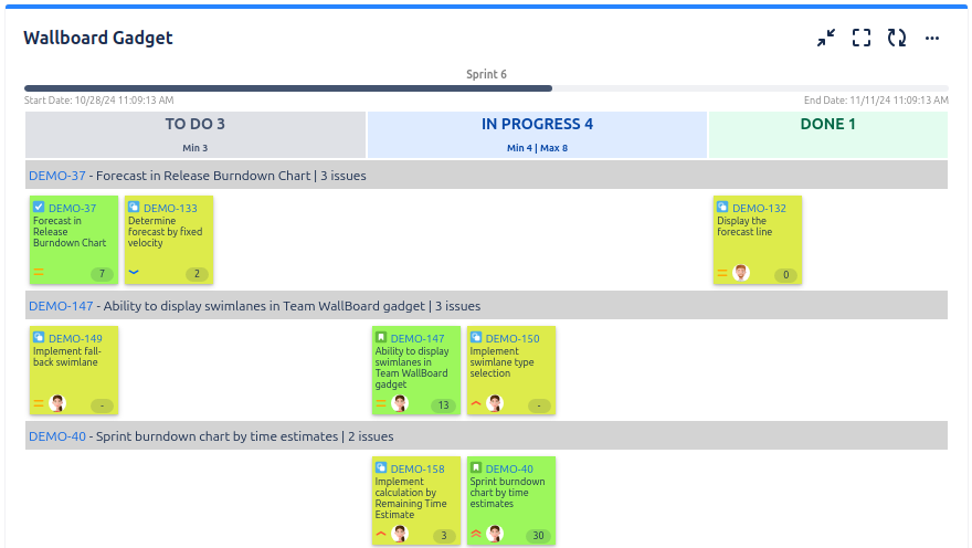

Also, if it happens to have our Great Gadgets app installed, you could try its Team Wallboard gadget, which can also display the contents of an the agile board by displaying swim-lanes by Stories (parent tasks).

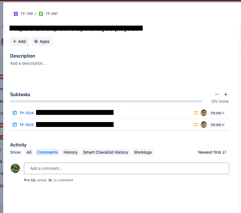

Can you provide a screen image of one of the issues in the Everything Else lane to illustrate that it does indeed have subtasks?
Ivan Wowk
November 4, 2024
Hey @Trudy P Claspill
Yep, see below
This issue is the top right in the 'Everything else' lane.

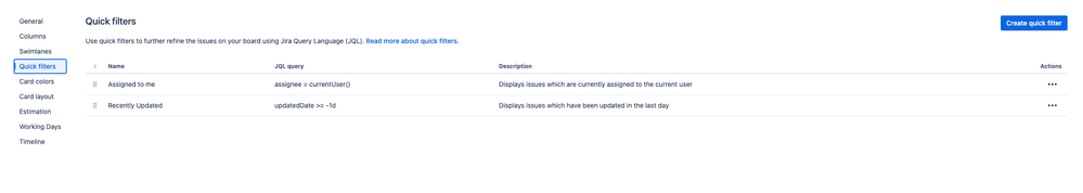

Do you have any quick filters activated in the board?

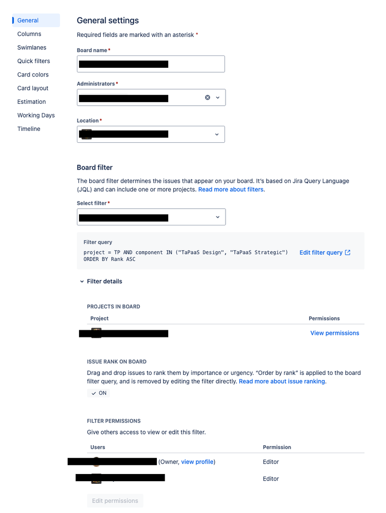

Have you reviewed the Filter Query being used to populate the board? Is there something in it that might be excluding the sub-tasks under TP-997?

I'm not sure. Can you tell from this?:

To view the Filter Query for the board click on the General tab show on the left on that same screen.
To show if you have any quick filters active we need to see a screen image of your board. Above the columns will be several pull down fields. That is the area we need to see.
Ivan Wowk
November 4, 2024
Does this help @Trudy P Claspill ?
