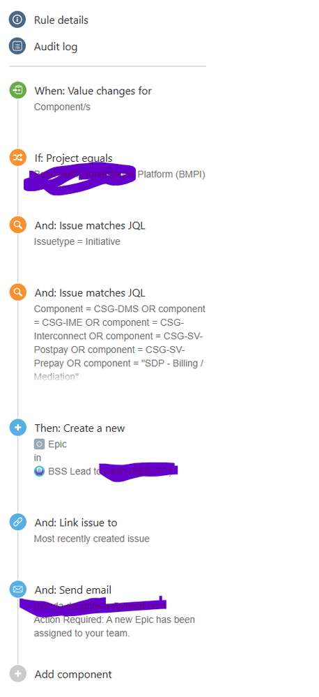

Chris.Buckley
August 5, 2025

You rule has issues
All clauses are OR, so no matter what the clause if the issue  component changes it will create an Epic.
So based on the trigger of the rule, if the field components is populated with a new option an Epic is created.
So you need to define when should an Epic be created?

Chris.Buckley
August 5, 2025
But the condition needs to be OR, if i have as AND, it will only create and epic if all are selected?
An epic should be created If one of more of these components are selected. But the epic would be for the same project, so only one epic is needed.

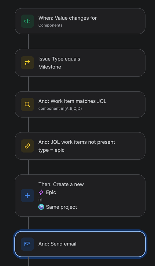

See this example (values used are different, adjust the to your needs)
The JQL items not present is a Related work items condition
