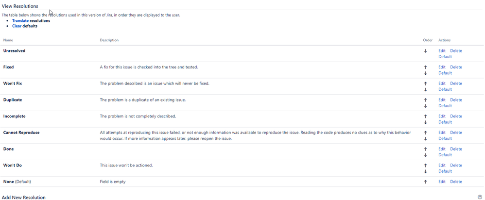

On a side note, I would also recommend going to the resolutions on your instance. Ideally you should not have created a resolution called 'None' on the instance. This is because the way Jira knows an issue is resolved is if the resolution field is filled up. Hence, I would recommend removing this from your instance.

Hi @Stephan Gruzinski welcome to the community.  Since this is happening on Edit I'd say there's probably some default value on the resolution field (probably none) was more then likely put there as a suggestion to remove the none values in select lists, remove this if it's there.  The other thing you might want to look at is an automation that sets the resolution on issue edit.
The point is any value in the resolution field marks the issue are resolved.  This field needs to be EMPTY until a resolution is reached.

Here is the current resolution setup.  What changes do you recommend, I am guessing probably clearing defaults but is there any other changes.
