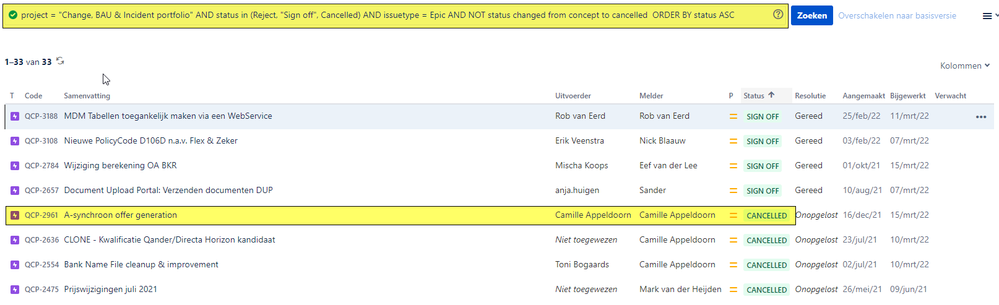

Here's a screenshot of the query and the results (be aware we're trying to exclude the status changes from concept to cancelled):

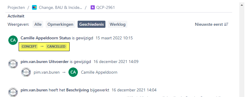

And here is a screenshot of the history of one of the tickets that should be EXCLUDED.
We already experimented with the case-sensitivity of the statusses being checked in the "changed from" part of the JQL-Query.

As far as I can see, the JQL looks accurate. Are there any other exceptions like QCP-2961?
