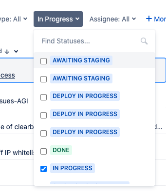

I'm showing the same status repeat over and over in the status filter when I do an issue search. We do have the same status types repeated across projects. Is this why? If so, is there a way to clean it up? You can't filter by status this way. status.pngstatus screenshot.png

Hi @Heather Dubin,
Yes, it looks like you have duplicates of the same status, and to clean it up you would have to identify which projects are using these statuses. The easiest way of doing that is to go to Settings > Issues > Statuses, from here you can see which workflows are using which statuses. I would recommend renaming the status you are planing to replace and remove to make it easier to identify the new one, then go to each workflow and replace the status.

You can reuse the same status on multiple projects.
Do you know if you are using both next-gen projects and classic projects? I just tested it in my test environment and the basic search will list the same status multiple times if you are using next-gen projects. If you switch over to JQL search you will not see the duplicates.

we are using Next Gen projects. I suspect the duplicated workflows came in as we were testing things and then discarded projects that didn't work for us.

Okay, so unfortunately there is no way of hiding duplicate statuses when using the basic search, and since you are using next-gen projects you cannot combine the statuses. Each next-gen project is its own island so to speak, nothing can be shared between the projects. There is a request to get this fixed, JRACLOUD-74037, you would see the same thing happen if you searched on custom fields with the same name. Go to the issue and add your vote to it if you want to see if fixed too.
