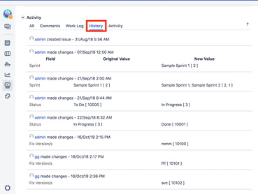

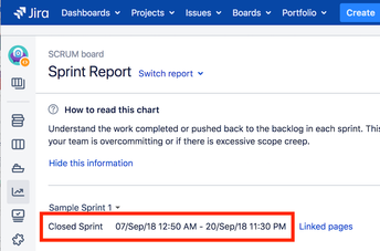

Andy Heinzer
November 13, 2018
The sprint report is only generated at the time the sprint is closed.  It is a snap-shot of what the sprint looked like at the time the sprint was closed.  I suspect that the sprint was closed, and then at sometime after that, the issue status changed to closed as well.
I would recommend going to the sprint report and checking the exact time the sprint closed.
Then compare this to the issue history of this issue in question.
I am interested to see if this issue's status changed after the time the sprint was closed to explain this behavior.
