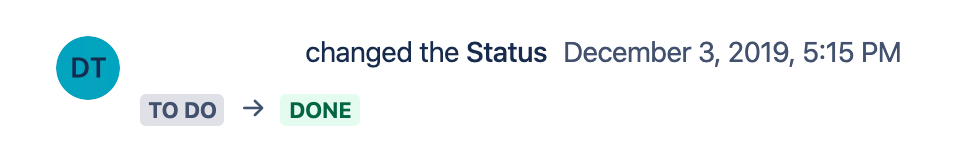

I would expect this query: project = ODM AND status changed from "TO DO" to "DONE" DURING (2019-01-01, 2019-12-31) to return this issue:
Screen Shot 2020-04-02 at 11.37.58 AM.pngBut I don't get any results. Is this a known bug with using status changed from/to? Please help.

Well, that is a defect and I was able to reproduce it.  There is apparently something special about Done status and CHANGED FROM/TO.
It appears you are trying to find all issues in 2019 which jumped from your backlog to done, skipping other workflow steps.  I found a work-around, although it is a bit cumbersome.  If Done won't work, let's instead exclude every other status which was CHANGED FROM during the time frame.

Josh Seder
April 2, 2020
Hi @Bill Sheboy - thanks for the response! The work-around you suggested worked, but even more concerning to me is that I'm seeing the same result when I search for issues that changed from "In Progress" to "Done".
