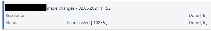

we have an issue added to "Sprint #7" which was completed on 08/06/2021. The issue was closed (Resolution = Done) on 02/06/2021.issue_closed.jpg

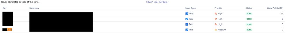

issue_sprint.jpgThis issue is now listed in section "Issues completed outside of this sprint" and the story points are not added to this sprint. issue_list.jpg
Is there an error in our database? How can I figure out why the issue is not listed under "Completed Issues" in this sprint?

Is "issue solved" in the last column of the board the sprint was created for?

Nic Brough -Adaptavist-
July 7, 2021
I don't think there's anything wrong with your database
The issue status is "issue solved", so it is not "done" (because "issue solved" is not in the last column, it's not done) and hence won't contribute towards the done count.

In the last column there is status "Done". The Ticket #2539 was changed from "Issue resolved" to "Done" on 02/06/2021. So, this are  6 days before sprint ends.
On 11/05/2021 this ticket was added to the sprint before it starts.
So in my opinion the ticket should be counted in Sprint #7 as completed?!

Heiko
July 7, 2021
Look to the picture at the beginning. We changed it from "Issue solved" to "Done", the last state of the issue.
News: I reindexed Jira 3 times now. After the 3rd reindex there were no errors now and da scrum board looks different. The count of completed issues per sprint are now increased and seems correct.
Was this the workaround/fix?
July 7, 2021
Sort of, but the real fix would be to fix whatever it was that corrupted your index!
