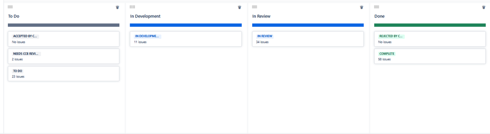

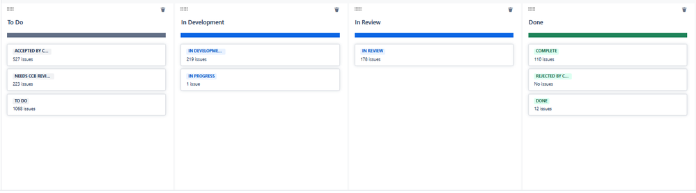

This is how the boards configurations are set up. I do not believe that this is the issue.
Multi-Team Board (Not Tracking Completed Work):
Team Board (Correctly Tracking Completed Work):
