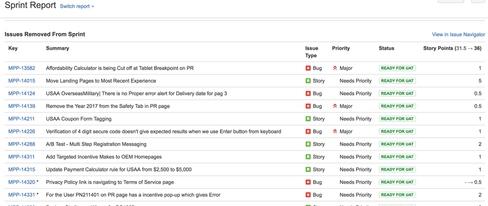

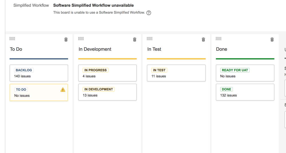

Hi there - running into the same problem, except for all of the statuses are mapped to the Columns in the board.  We are also setting the Resolution to Completed.
We have two types of Closed states in our Workflow:  "Done" and "Ready for UAT".  They are both green workflow statuses AND we have a Resolution set when users move to this part of the workflow.  Both of these statuses are mapped to the Done column of our Scrum Board as well.
When users transition issue types to "Done", this will get counted towards our burndown chart and sprint report; however, if we move the issue to "Ready for UAT", the issue type immediately gets Removed From Sprint and you can see this in the Sprint Report under "Issues Removed from Sprint".
Both the "Done" and "Ready for UAT" sates are configured the same, with the same transition screens and everything.  Super stumped; hoping someone can help out!

I figured out the problem, at least for my scenario.
I created new statuses and did not map them to any columns on the board. JIRA was actually warning me, but I didn't understand the warning. Once I put all status in columns, things worked as expected.
The screen I'm discussing is under the configuration screen for the board, and then choose "Columns" from the left pane.
