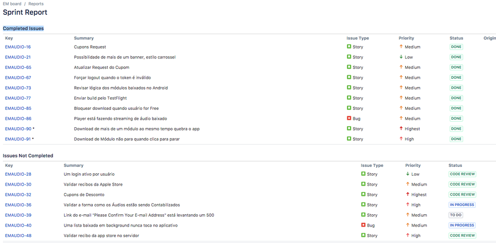

Currently, the sprint reports show issues as completed ("Completed Issues" section) only based on the column name.
Is that possible to generate reports displaying all issues with "statusType == Done" as completed?
For instance, please refer to the screenshot below. I'd like my issues with "status == `Code Review`" to be marked as done in the report, together with the issues with "status == Done". Is that possible?

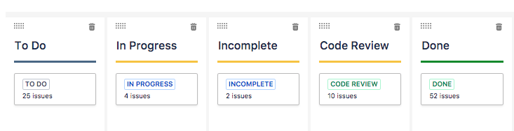

Below are the columns I've being using:

Isn’t it enough to create a dedicated board for the report you want, where you set both statuses in the Done column?
