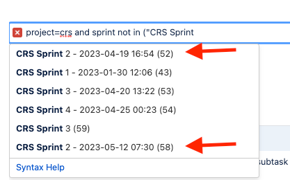

I thought I had reproduced what you saw, but what I discovered was that I actually had two sprints with identical names. While I thought I was excluding issues in "CRS Sprint 2", I still saw issues in the result saying they were assigned to "CRS Sprint 2". I looked more closely at the list of sprints that showed when I was typing in the sprint name in the JQL and saw that two matches were shown.
Can you confirm that you don't have multiple sprints (9917 plus another) that have identical names?

Bruce, Luke
June 7, 2023
Thanks both. 9917 is the sprint ID so this is unique as are your IDs shown above so this unfortunately isn't the cause either. Sounds like we'll need to raise support ticket.
