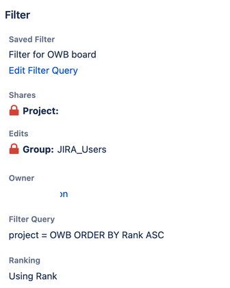

Let's stick with the board filter to diagnose this: if the filter is ambiguous it could still be trying to access multiple projects, as described here: https://support.atlassian.com/jira-cloud-administration/docs/use-manage-sprints-permission-for-advanced-cases/
Would you please post your board's filter?  That will help to confirm if there are JQL issues.  Thanks!

Here is the screenshot. Pls let me know if this helps.
Filter Query: project = OWB ORDER BY Rank ASC

That filter looks good to me, so I am out of suggestions.
At this point, you could wait a bit to see if others post suggestions and/or submit a ticket to Atlassian Support to see what they say.  They can see logs we cannot access and so may notice something causing this.
