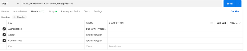

I am trying to create an issue in jira via postman and always getting this error - Specify a valid project ID or key when trying to create an issue of type task
Request -->

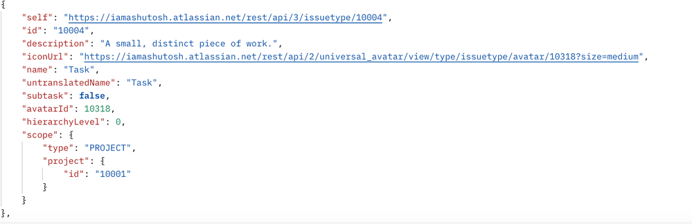

The issue type references a Task.. below is the information about the issue type returned from callout to https://iamashutosh.atlassian.net/rest/api/3/issuetype

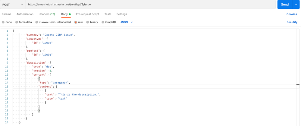

I was able to fix the issue.. the issue was because of incorrect structure of data being passed. Pls see below updated structure of data being passed that fixed the issue.
"fields" : {
"summary": "Create JIRA issue",
"issuetype": {
"id": "10004"
"project": {
"id": "10001"
"description": {
"type": "doc",
"version": 1,
"content": [
"type": "paragraph",
"content": [
"text": "This is the description.",
"type": "text"
