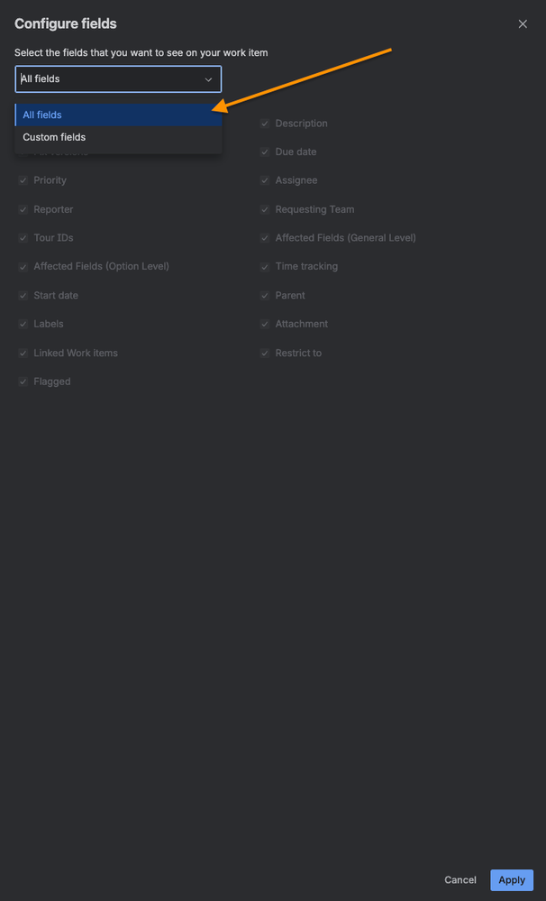

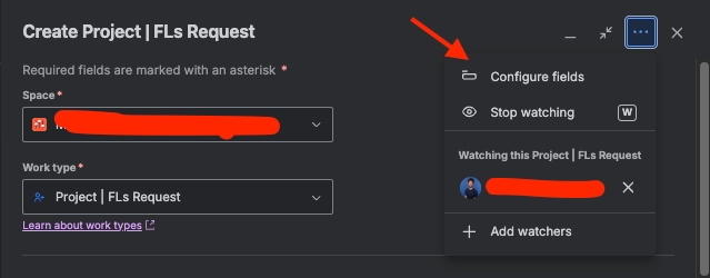

My goal is for each Work Type to display a specific set of fields to the Reporter by customizing the "Configure field" option (please see attached screenshots for reference). However, after configuring and applying the changes, the settings are not saved—the configuration reverts to the default state each time.
You access the fields configuration here:
You select what fields you want to display as a Reporter by selecting Custom fields and you are expecting that from the moment you apply this selection all Reporters will display the set of fields you want them to see for that Work Type. Otherwise, if you select All fields, the Reporter will display all fields
In reality this does not work. After some time the configuration you saved is no longer there and it is displaying some "random" fields for no reason. Plus, if you are changing the configuration for a Work Type, it is going to mess up the fields configuration with the other Work Types.
The only workaround I found is to select All fields. In this way the system will display all fields for all Work Types (even if you choose this option to be applied only to one Work Type) and to make sure the Reporter will not use fields I wanted to keep hidden from them during the ticket creation, I will need to write DO NOT USE in the descriptions of the fields, so that I will fill those fields once the ticket is created and I can process it.

The Configure Fields option within the Create dialog is not a global setting. That is an individual user preference setting. This is by design.
I don't think the design includes retaining the configuration for each project/space and work item type.
If you want a specific set of fields used for each work type, go to Space Settings > Work Types. Select a work type. Ensure that in the center section of the display where it shows Description Fields and Context Fields you have there only the fields you want displayed for that work type. Any field that you don't want to show, click on and drag to the panel on the far right. Save any changes you make. Do that for each work type.
It will still be a user preference whether or not all fields or a set of custom fields is displayed in the Create dialog, but if the All Fields option is displayed then only the fields in the Layout for that work item type in that project should be displayed.

That configuration in the Create dialog for displaying All Fields or Custom Fields does not support:
  1. specifying All Fields or Custom Fields based on the selected project
  2. specifying All Fields or Custom Fields based on the selected issue type
  3. specifying All Fields or Custom Fields based on the combined selection of  project and issue type.
It is a user preference, not a global configuration option, or a project or issue type configuration option. When a user selects the All Fields or Custom Fields option, their preference applies to all projects and issues types for that one user when they are creating items.
The configuration is "saved" as either All Fields all the time or Custom Fields with the specific custom fields specified.
If I understand your experience correctly, it "messes up" when Custom Fields is selected because
  1. The user is initially viewing issue type A, and selects custom fields applicable to issue type A.
  2. The user then wants to create an issue of type B which has a different set of custom fields. But the configuration can "save" only one set of selected custom fields. So, when issue type B is selected the dialog displays what ever fields were selected for issue type A that are also used in issue type B.
There is a change request asking for the option to be able to set the configuration to "All Fields" for all users. You should add your vote to it.
https://jira.atlassian.com/browse/JRACLOUD-87453
I don't see a change request to have a global setting for setting the Custom Fields option with selected fields to affect all users. Nor a change request to be able to have those user preferences recorded per project, per issue type, or per project/issue-type pair.
