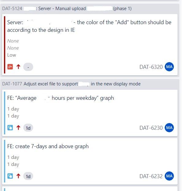

Here's our current Scrum board view (from one of the columns), swimlines are set by assignees:
I'm trying to sort between the 2 stories on the board while the story is assigned to someone else (multiple sub tasks to multiple assignees on the same stories) but it doesn't work.
if the story was assigned to the same assignee, you can drop & drop them but not when the story is assigned to someone else.
Is there's anyway to sort them on the column without using priorities instead for rank?

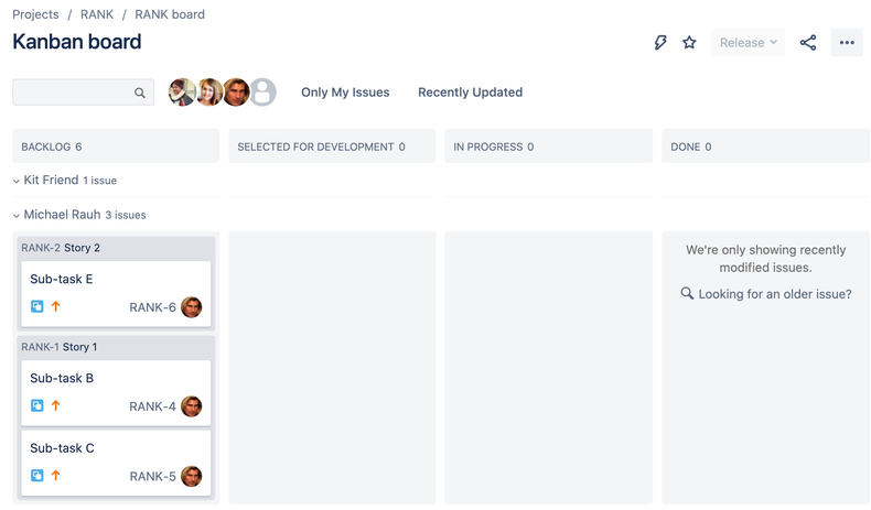

  1. Let's walk through this... here's your swimlane for Michael (In my head I immediately assigned him as being a QA) - poor old Mike doesn't get assigned anything sexy like a whole story, he just gets a smattering of sub-tasks. In this screenshot we can see that Story 2 is prioritised over Story 1 for him, which we want to fix. As you noted above @[deleted]

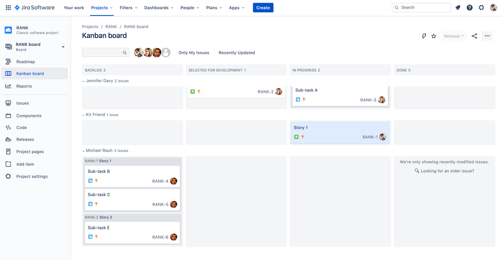

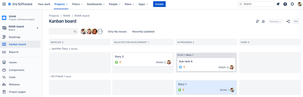

2. ...and for whatever reason, his team mates Jennifer and Kit have got the parent stories in multiple statuses, meaning there's no handy way to drag and drop them in and order on top of one another in a column:

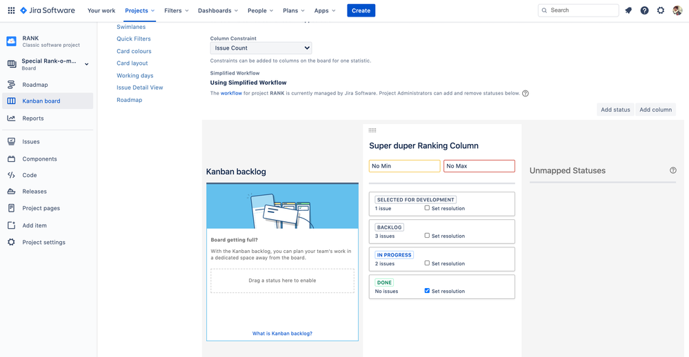

3. So! We have to create our magic Special-rank-o-meter board to enable us to manage our priorities in a macro sense. Here's the column/status config...

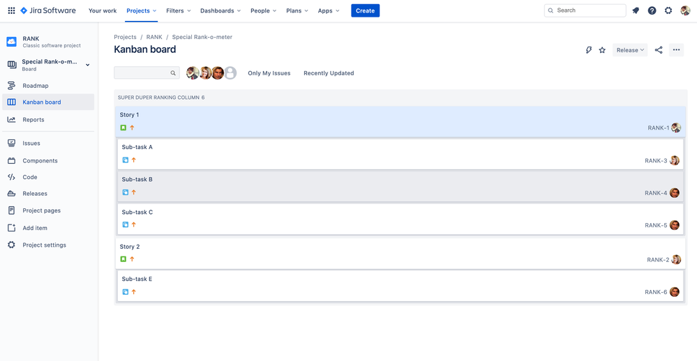

...and what it looks like (you could exclude sub-tasks or have a quick filter that hides them if you want also - you can re-order them within their parent, but sub-tasks get carried up/down with their parent stories):
4. After all that fun and games ranking, when we go back to our 'real' board, Michael's sub-tasks now reflect the global ranking we've declared in our special board:
