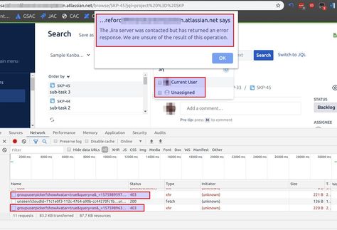

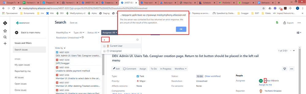

I have an issue with using Jira. When I trying to sort tickets by reporter or by assignee I have ability to choose only my profile. And when I start enter searched username I get a message:
"The Jira server was contacted but has returned an error response. We are unsure of the result of this operation." right after first letter was entered.

Unfortunately I don't have ability to attach video example of the actual behavior. But in all suggested cases issue is appears in all projects. And even if no project or additional search criteria is selected anyway issue present

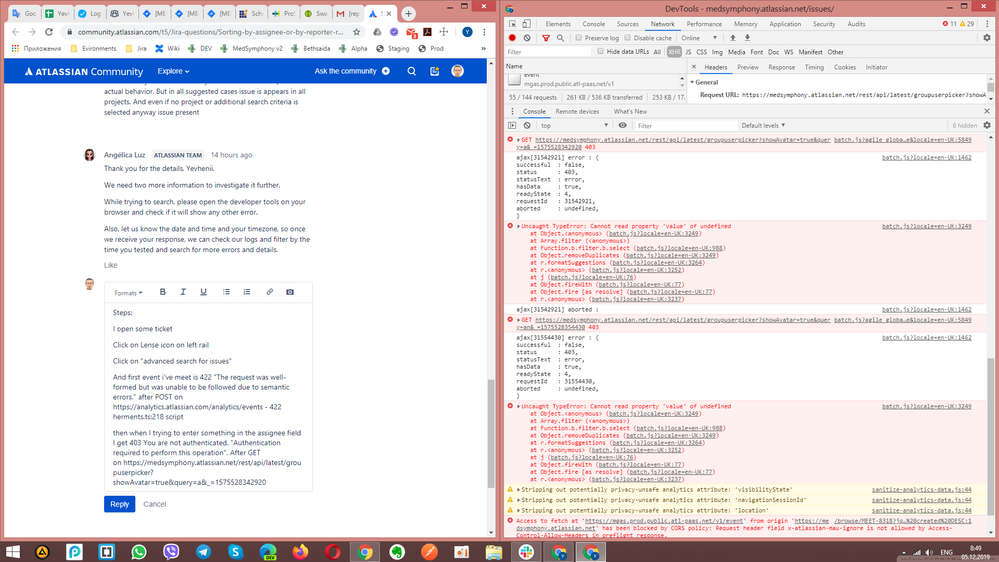

And first event i've meet is 422 "The request was well-formed but was unable to be followed due to semantic errors." after POST on https://analytics.atlassian.com/analytics/events - 422 herments.ts:218 script
then when I trying to enter something in the assignee field I get 403 You are not authenticated. "Authentication required to perform this operation". After GET on https://medsymphony.atlassian.net/rest/api/latest/groupuserpicker?showAvatar=true&query=a&_=1575528342920
console shows:
Screenshot_45.pngMy date of the search is a 5 of december 2019 8:40 - 8:50 GMT+2

Thank you for the screenshots and information. I found one error on the logs but it doesn't help to figure out what is the cause.
The Uncaught TypeError might be related to some add-on. Can you please ask for the admin to check the list of the add-ons and let us know the ones you are using? So, I can install here and test if the same issue happens.
