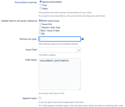

My suggestion is to add the post-function Update Any Issue Field (JSU) on the transition to "Ready For Review" status and define the value of the custom field as %%CURRENT_DATETIME%%
Every time the issue transition to Ready For Review the date will be logged and you can JQL this field.

jira_admin_cu
November 5, 2020
Hi @Alex , Thank you, I tried this approach and it is working as requested.

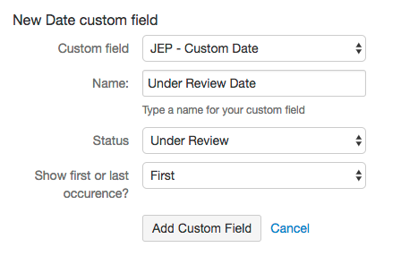

Enhancer Plugin for Jira has date fields that can help you with your requirement.
Just navigate to the Date fields section in the Enhancer plugin for the Jira menu, add your Status Entry Date, select the status you want to show information about, add it to the necessary screens and it'll start capturing details. Alternatively, if it suits your workflow, you can also use built-in First In Progress/Reopened/Closed Status Dates.
You can also obtain historical information about the already existing issues too. These fields are searchable, sortable and you can use them in reports too. Also, JEP has dedicated gadgets that can help you to track your progress.
