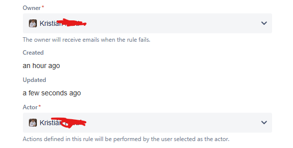

Hello,
I got problem with automation.
I got couple issue types in project, for testing purposes I have created a simple automation which will just add Test to Log.
Problem is that for 2 of my 9 issue types, I didn't even receive an error in Audit log when I create an issue.
Actor of Automation have Administrator permissions in project.

Thanks, that was exactly my problem, in post functions I have had:
Fire a No Notification event that can be processed by the listeners.
Instead of
Fire a Issue Created event that can be processed by the listeners.
