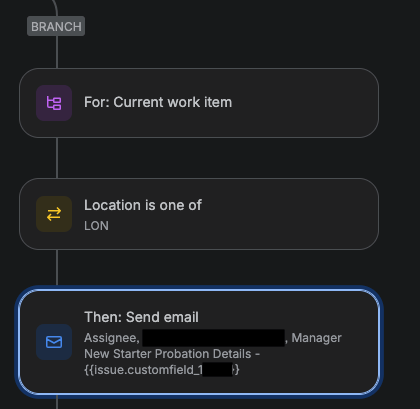

It's a separate branch within the same automation if that helps clarify. Here's a screenshot of the branch.

Mikael Sandberg
August 21, 2025
Okay, so either before the branch or within the branch add the Re-fetch component, that way the automation will get latest state of the work item including changes made within the rule.

Cody Clements
August 21, 2025
That did it! I've been beating my head against this for a week. Thank you!
