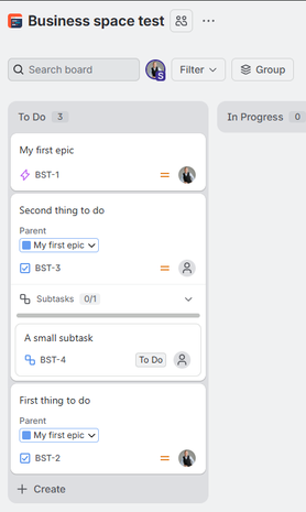

I just checked in my own instance and subtasks are visible when running the standup from the board, both in Business and Software Spaces.
It doesn't matter if the Parent issue is assigned or not (or the subtask itself). Everything visible on the board is also visible during the standup. It also doesn't matter if the subtask is Done or not
So it *should work* as you expect
You can test and change the "View settings" in the upper right corner but I think it would affect both the board and the Standup view in the same way.

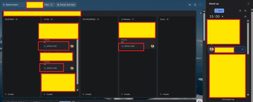

When I group the board by Sub-tasks, sub-tasks assigned to other team members do appear in the Stand-up view. It's only 2–3 specific assignees who are missing, even though they also have sub-tasks assigned.
That's my exact concern.
Marc -Devoteam-
July 30, 2026
Hi @Megha Das
Are these sub-tasks in a different space? do these users have correct permissions on the space the Stand-up is done in?
