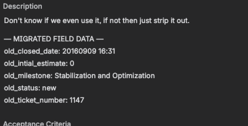

I am working on cleaning up old unused fields in jira. Our company acquired 3 companies over the past 4 years and there are tons of fields that are not used anymore. We want to preserve the values. The solution I came up with is to append the description field at the end with the values I want to preserve.
See image below for example.
My solution to do this is using postman to grab the description field as well as the values I want to preserve and then via the API and Postman's test scripts feature make the modifications to the description field. This works well, however it takes a long time (2 hours to update 6,000 tickets) because its making 2 calls, first to read the data and store them into variables, make the modifications and then the put call to put newly updated description.
I have to update 130k+ values via this method and this would take 45 hours to complete. Looking for solutions to help accomplish this faster.
Below are my API calls as well the the post-response scripts just in case anyone wants to see the details of what I am doing

3 answers
2 votes
Akash Singh
March 12, 2026
@Jeffrey Bistrong
You’ll need to develop a script that can execute these actions concurrently. I’m not certain whether this level of concurrency can be effectively achieved using Postman scripts. However, if you have some familiarity with Python or JavaScript, implementing this should be quite straightforward.
Be sure to incorporate a semaphore (or similar concurrency control mechanism) to limit the number of parallel requests and prevent hitting API rate limits. It’s also recommended to implement retry logic with exponential backoff to gracefully handle situations where rate limits are exceeded.
With these optimizations in place, you should be able to build a sufficiently fast solution that can complete the entire process within an hour or less. Additionally, you can leverage an AI coding assistant or model to help you quickly generate or refine the script if needed.
