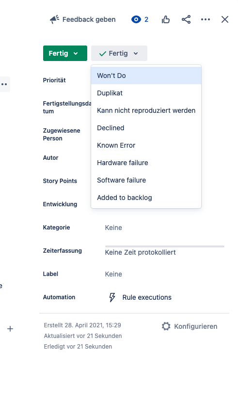

3. One time its the resolution field and the other is the status (see screenshot 1)

1 Screenshot

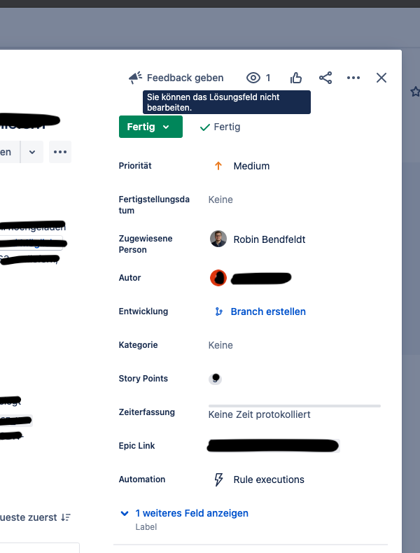

I deleted the resolution field out of the issue screen and now I can't choose anything from the resolution field. But a value of the resolution field is displayed.

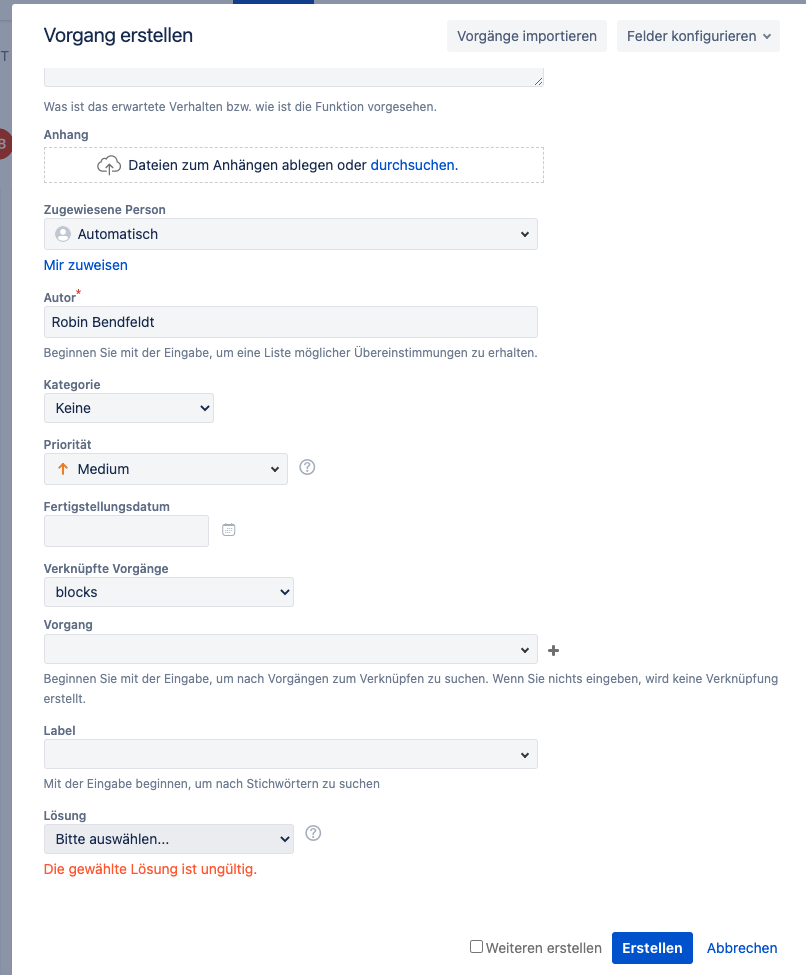

2 Screenshot
In this screenshot the resolution field is not deleted out of the screen and if I want to creat a new issue I have to choose an option out of the resolution field otherwise I can not creat a new issue. (see last field "Lösung" its german for resolution).

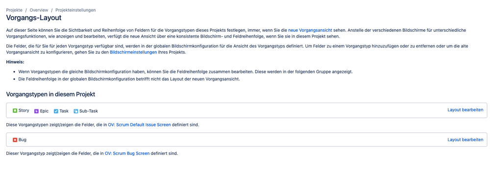

1. Screenshot
On this screen I choose which typ of issue I want so change, but the changes are shown on the creat and edit screens.

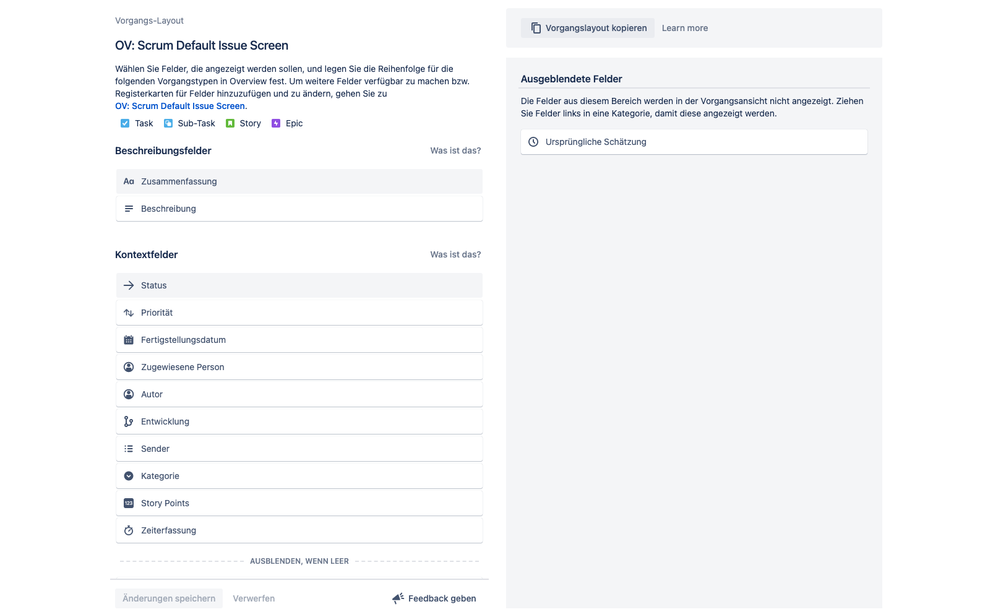

2. Screenshot
In this screen I change the appearance of an issue just for a single project.

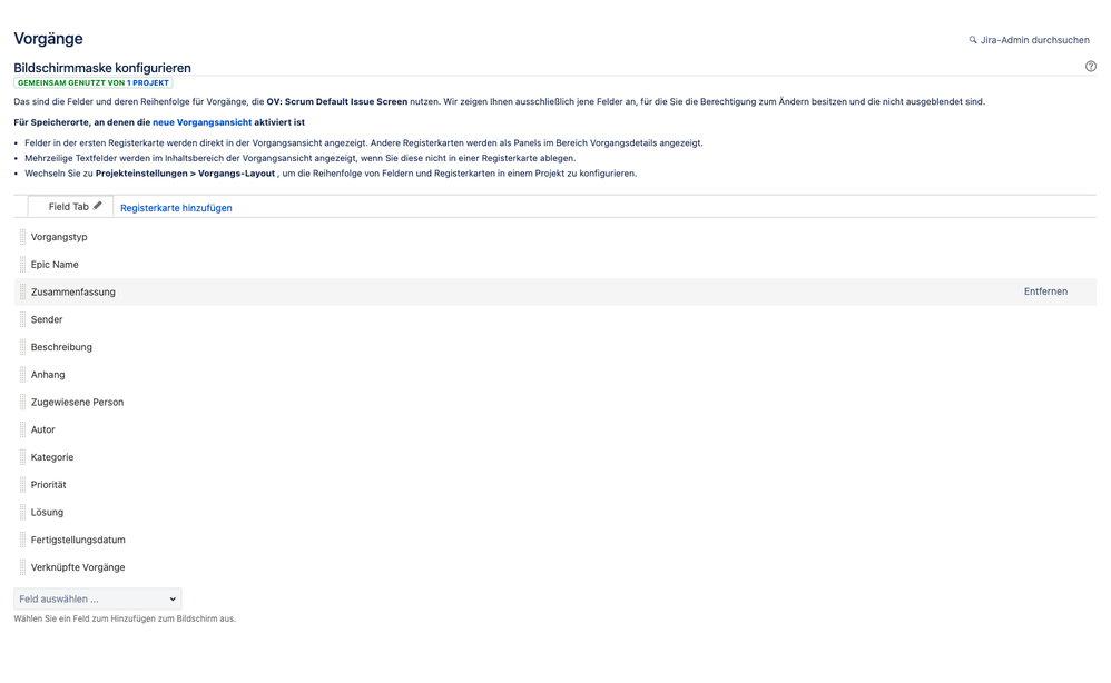

3. Screenshot
If I need more or other fields for the screen in screenshot 2 I have to go to this screen to add fields.
