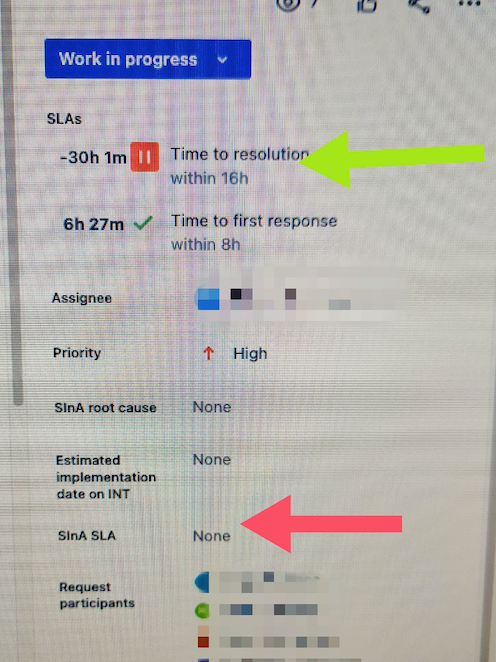

I have attached a screenshot to this message [IMG...], I would love to show the time value that appears in SLA Time to resolution (customfield_10070 the green arrow) in the freshly created field SInA SLA (marked with a red arrow). I want to do that in order to create automatic reports of time of the cards.
We think we should use a smartvalue in order to accomplish that using the field id of SLA Time to resolution (customfield_10070) the green arrow field. But no matter what we never get a time value in the SInA SLA red arrow created field.

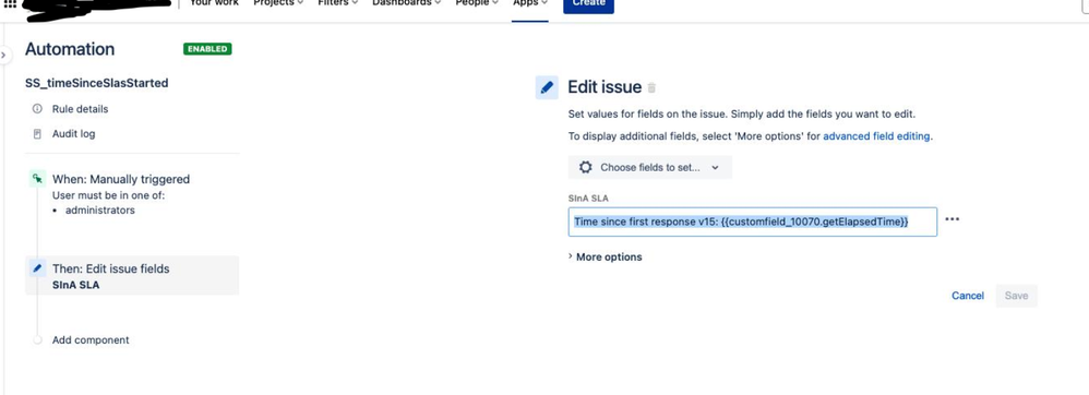

Time since first response: {{customfield_10070.getElapsedTime}} this is one of the examples we're trying to use to make it appear. Also we tried with issue.fields.customfield_10070.ongoingCycle.elapsedTime...
Finally I will attach a screenshot of the automation rule we are executing to try to make it work.Captura de pantalla 2021-02-12 a las 14.04.19.pngCaptura de pantalla 2021-02-12 a las 13.49.53.png

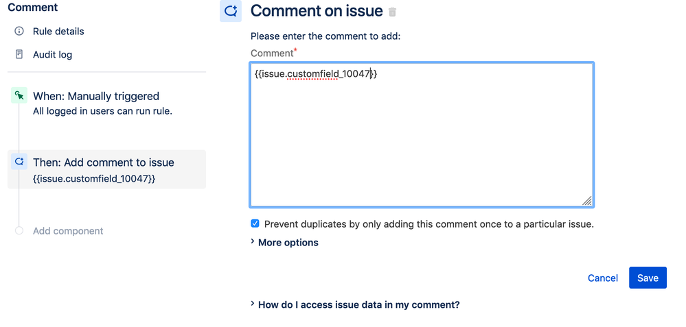

Typically what I do if I want to access information on large objects is to first check the JSON that they return if you just call them. So in this case, I started with a manual trigger and set it to add a comment to my ticket so I can explore the object I'm working with.
Then I run the rule and check what it added to my ticket. You could also do this with the Log Action action, I just have a lot of test environments so I don't mind logging comments to some of my tickets.
