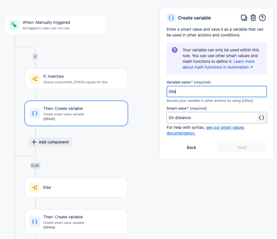

Although for clarity and simplicity, you might want to do this with an IF/ELSE block:

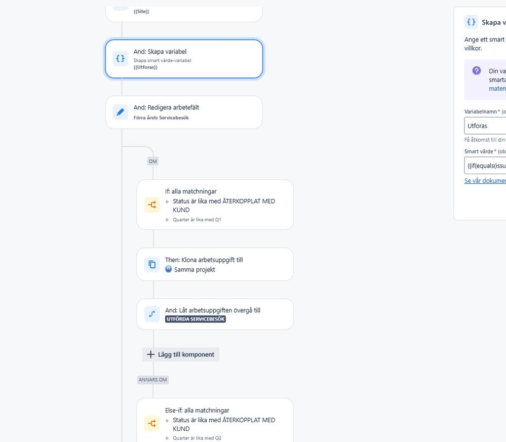

My problem is that i already have an IF statement after my creation of the variable. and am having technical dificulties to make several if`s in the same automation.. but thats problebly my own limit of knowlage that stops that :/ or is that possible to add another if statement before then ? :-O

Hum, my Swedish is a little rusty (hehe), but I'm thinking that a possible problem with multiple IFs (as well as using {{#if}} within Smart variable creation) is that Automation actions execute in parallel (asynchronously). (AUTO-32)
Which means that it's possible {{Site}} is not yet defined by the time you try the Edit action to update Summary to:
SB - {{issue.customfield_10073}} - {{Site}} - Q1 - {{Utforas}}
(Also, you'll probably want to use {{issue.customfield_10073.value}} there.)
