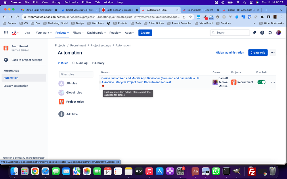

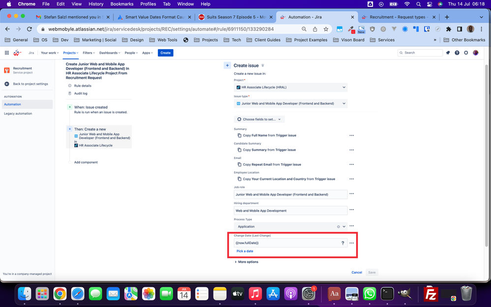

Hi @Stefan Salzl herewith the screenshots. I do not however have access to the audit log due to my current plan. However, if I remove the field concerned (Highlighted in red in screenshot), the automation runs successfully.
Thanks,
Barnett

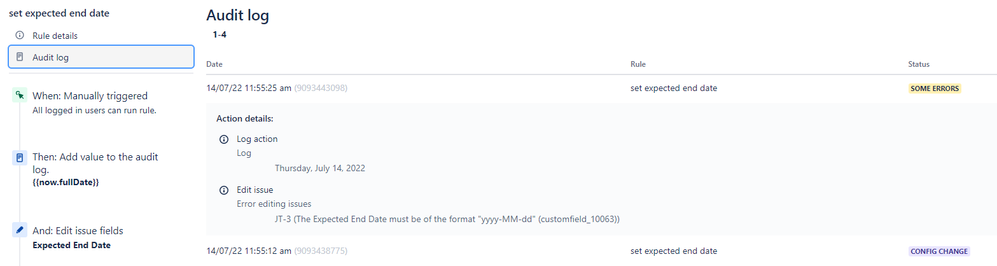

Thanks for the screenshots. The activation logs of the automation rule should be accessable in any Jira Plan.
At the top of your automation rule you can see the "Rule Details" and "Audit log". Could you click these options and send screenshots?

As far as I can confirm the date fields in Jira don´t accept fullDate (tried this in my instance --> see screenshot). This was a date-picker field. Tested it with Time & Date picker with similar result.
What would be your main reason to write fullDate to the field? The field (in case it is of type dateTime) would still show the timestamp and the date when filled with {{now}}.
