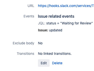

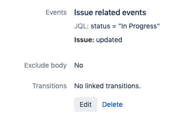

I just tried to simplify JQL condition and:
This one work only when move task from in progress
Also i tried this one moment ago and get notification only when task has been moved only from  "Waiting for Review"

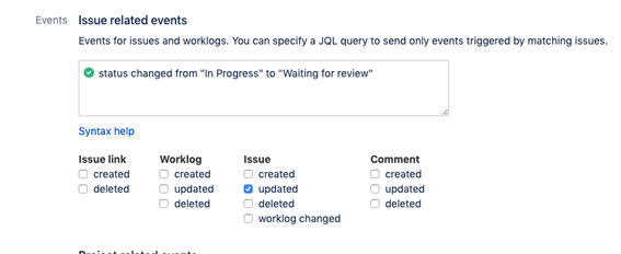

Try this JQL
status changed from "In Progress" to "Waiting for review"

despieros
May 24, 2019
Hello,
Thx, It works with transition "In Progress" to "Waiting for review", but only if i change status manual in JIRA, and still not working when status changed by creating pull request in Bitbucket.

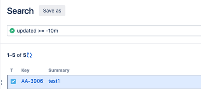

I see you are testing with issue's
Please tell me this does your issue appear on the list when you are using this filter issue search, you need to update or create this issue within last 10 minutes if the search shows it than slack should read it.
updated >= -10m

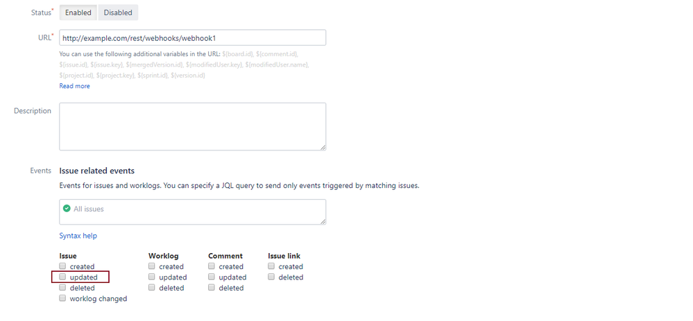

Also on your screenshots, I don't see this part where you can select the event
despieros
May 24, 2019
Screenshot with updated flag:
Search:
i did update in test task and try to search after.

Your webhook listener should be set up:
Event
Issue updated and you should add jql condition
     JQL condition status = "Waiting for review"
