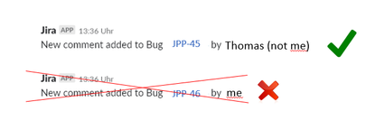

I use Jira Server Alerts in Slack through a webhook. I would like to see all changes (this works) but not the ones where I did the change:
Choosing assignee in JQL does not work, as for example I don't need to be assigned but only write a comment. Do you have an idea?
