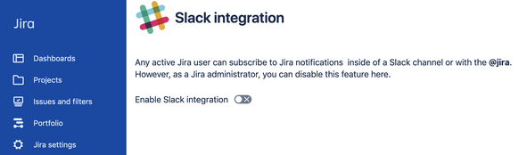

On that page, you'll see a toggle to flip the integration On or Off - example of it off here:
What you want to see is the toggle enabled - you can simply click it to enable it:
Give that a shot and let me know how it goes!

this is awesome thanks so much for the link! its working great now
