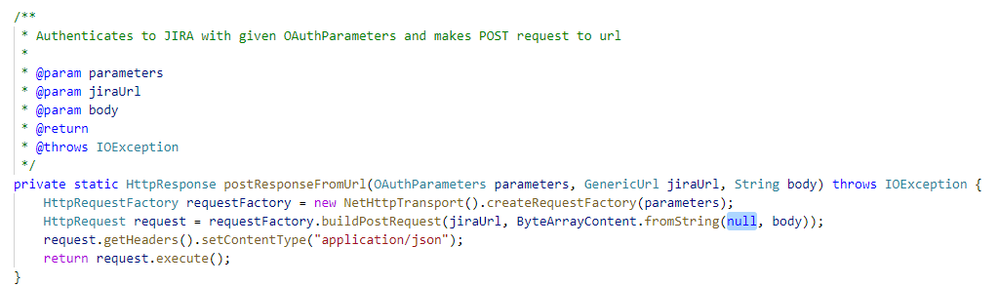

But we are now I am stuck with POST calls. Is there an example to do that?
I tried to extend the OAuthClient.Java with this method but always ends up in Error 405 - Method not allowed

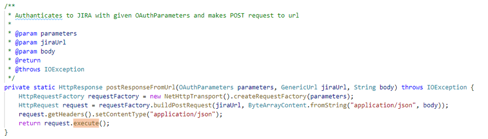

Problem is fixed!
Also make sure that the POST request body is specified correctly:
In my case I used VS Code for debugging - the double quotes are escaped properly only on using three backslashes \\\
Eg:
"{\\\"globalId\\\": \\\"82411\\\",\\\"object\\\": {\\\"url\\\": \\\"http://google.com\\\",\\\"title\\\": \\\"This is a remote link\\\"}
