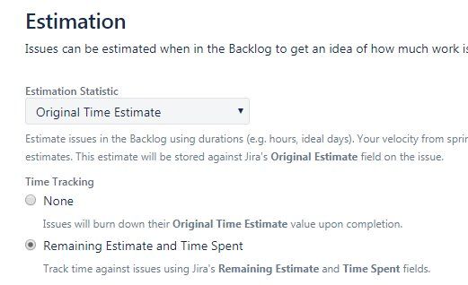

Warren
February 9, 2018
you're right, it is specific to the way we have our settings, see below

Stephen Meehan
March 27, 2023
I had the same issue with Sprint not showing the total time at the bottom and realised that the 'Estimate' section on the left under 'Board Settings' needed changing from 'Story Points' to 'Original Time Estimate'. It now shows the total.
Zaheer Khan
October 10, 2022
you need to change the estimation method on the backlog and on the Active sprints to be the same, ideally, they should be using Original Estimate with the Time tracking option switched on.
