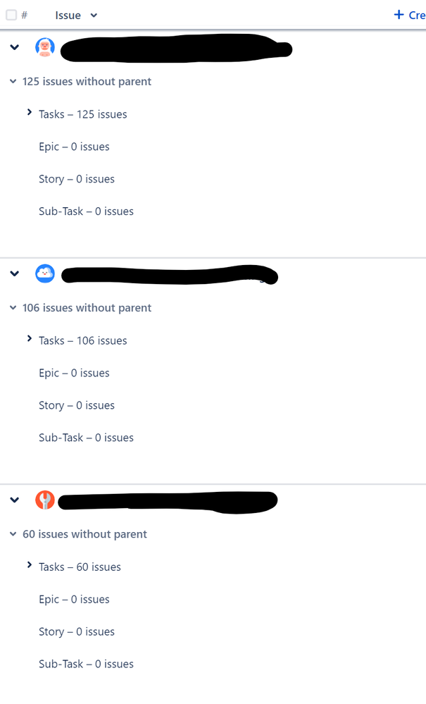

Thanks Alex,
Please see attached advance roadmap screenshot.
Somewhat confusing to me is that there are tasks showing under tasks in it's own category instead of grouped within the Epic, which the task is linked to the Epic itself.
Is this because that the issue types are not tied with a parent?

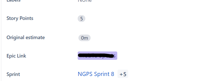

Linked using the Epic Link?  Or linked using Linked Issues?
Reagan Chan
June 12, 2022
Using the Epic Link
