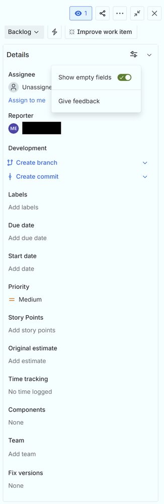

In the first project, when creating or editing an issue ("work item" in the new lingo) the Details section features a collapsible filter setting that exposes a toggle button labeled "Show empty fields." Toggle the button to "on" inserts all empty fields into the Details column directly. There is no additional "More fields" collapsible area at any time below the Details section.

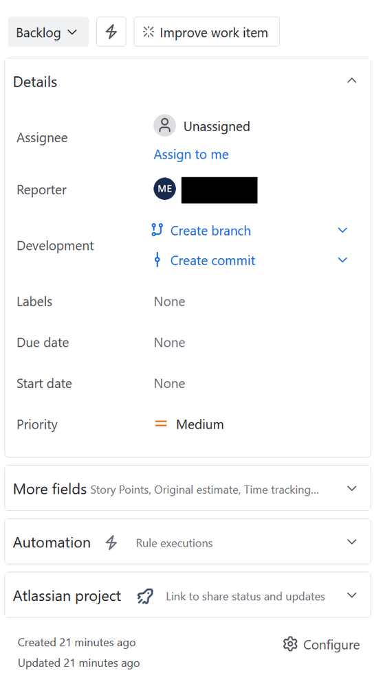

In the second project, under the same activities, the Details section does not have this filter setting and instead has a collapsible section labeled "More fields".

First project created TWO weeks ago...

Second project created yesterday...

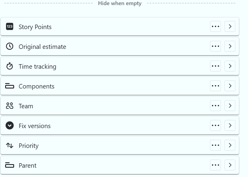

In both cases, the Field settings include the same fields for "Hide when empty":

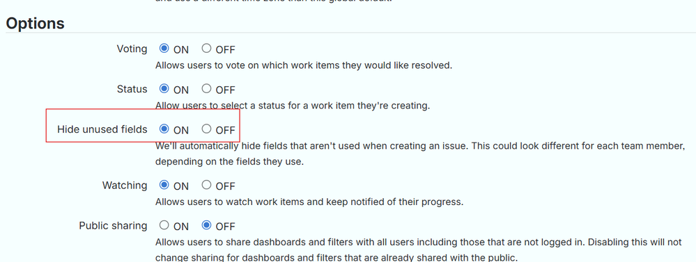

And in both cases, the System Settings "Hide unused fields" option is set the same way...

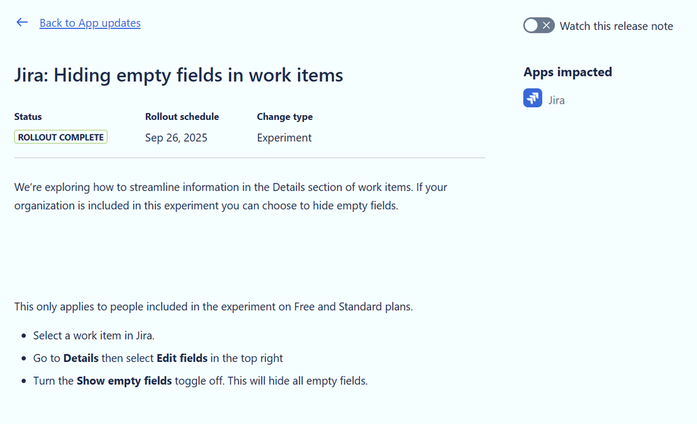

On all the Cloud systems to which I have access (which includes a Free subscription and Premium subscriptions) I see only the second view with the More Fields panel.
The first view with the filter in the header of the Details panel may be an experiment that Atlassian has deployed to a subset of systems to get feedback. They occasionally do that and don't post any notification about it.
There is a toggle for disabling Experimental code at the Organization level.
https://support.atlassian.com/organization-administration/docs/manage-atlassian-experiments/
You might have to reach out to Atlassian Support to get an authoritative answer.

Wow. I think you are absolutely correct. My one instance is part of this A/B test nonsense. There's no way to turn experiments off unless you are on an Enterprise plan. Thanks Atlassian! Ugh.
Screenshot of relevant update that appears in the instance that includes the toggle...
