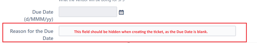

I am trying to create a script that shows or hides a single line text field called "Reason for the Due Date" based on the value of a date field called "Due Date". Although the script is working, the "Reason for the Due Date" field is visible when the ticket is initially created, even when the "Due Date" field is blank. Ideally, the "Reason for the Due Date" field should only be visible when a value is entered in the "Due Date" field and should disappear when the "Due Date" field is blank.

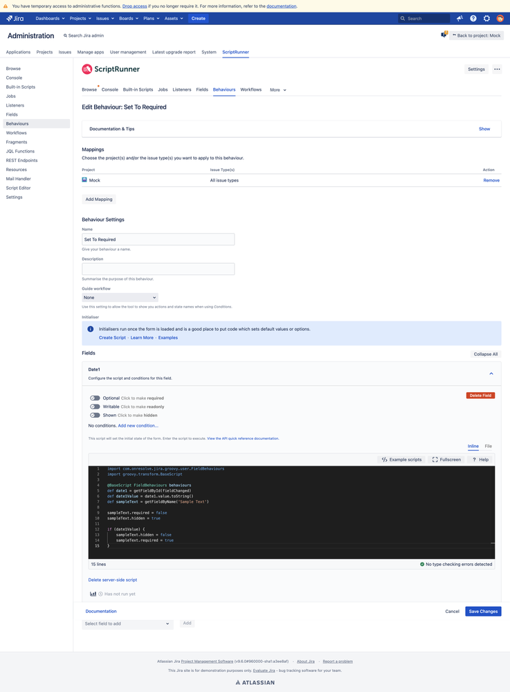

Also, for your code to work, you must use the Server-Side Behaviour for the Date Field.
Below is a sample working code for your reference:-
import com.onresolve.jira.groovy.user.FieldBehaviours
import groovy.transform.BaseScript
@BaseScript FieldBehaviours behaviours
def date1 = getFieldById(fieldChanged)
def date1Value = date1.value.toString()
def sampleText = getFieldByName('Sample Text')
sampleText.required = false
sampleText.hidden = true
if (date1Value) {
sampleText.hidden = false
sampleText.required = true
Please note that the sample working code above is not 100% exact to your environment. Hence, you will need to make the required modifications.
Below is a screenshot of the Behaviour configuration for your reference:-

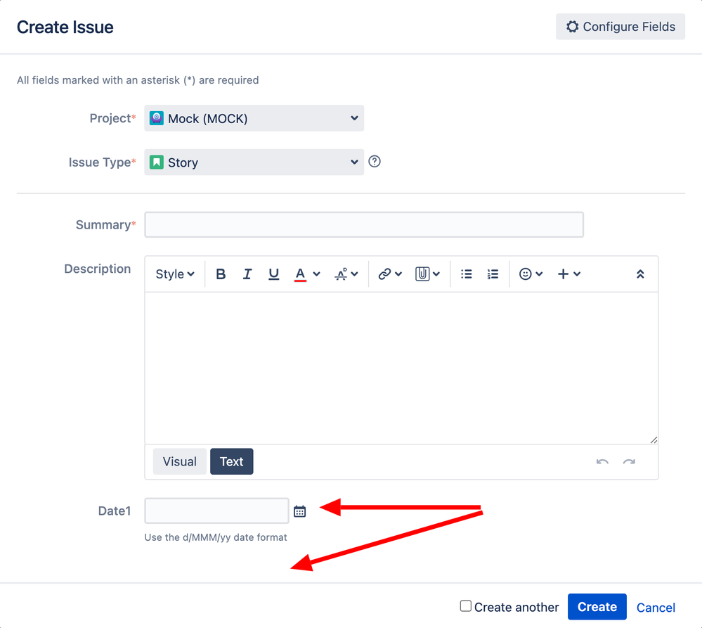

Below are a couple of test screens for your reference:-
1. The Date field is empty by default when the Create screen first appears. Hence, the Text Field is set to not required and is hidden.
2. When the value is set for the Date field, as expected, the Text Field is now visible and is set to required, as shown in the screenshot below. If the Date field is cleared, the Text Field will not be set to required and hidden as expected.

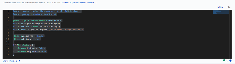

am not a hardcore developer, took the reference of your code. log says no failure in executions.this is at the issue creation stage
def Date = getFieldById(fieldChanged)
def DateValue = Date.value.toString()
def Reason  = getFieldByName('Live Date Change Reason')
 Reason.required = false
 Reason.hidden = true
if (DateValue) {
    Reason.hidden = false
    Reason.required = true
Your help is much appreciated. Thanks
The script is working now but the requirement is whenever at any stage the Live date changes Live date change reason should be mandatory for the users every time.
