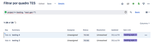

You can use the Filter Results Gadget to display the issues as you need. These would be the steps:
1 - navigate to your issue navigator page and type a query (Using advanced mode) to return all the issues you want, using the "project in" parameter to define the projects where the issues are placed. For example:

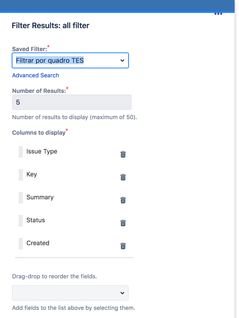

3 - Navigate to your dashboard > Click to Add Gadget > Add the filter results gadget
4 - Configure the Gadget with the filter you created
