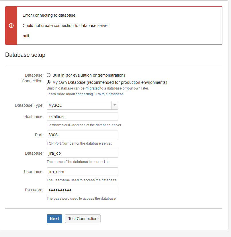

I have followed the tutorial https://linoxide.com/tools/install-jira-on-ubuntu-linux/ but at the stap 4 I cannot connect to my Database (Error null - see Picture below).

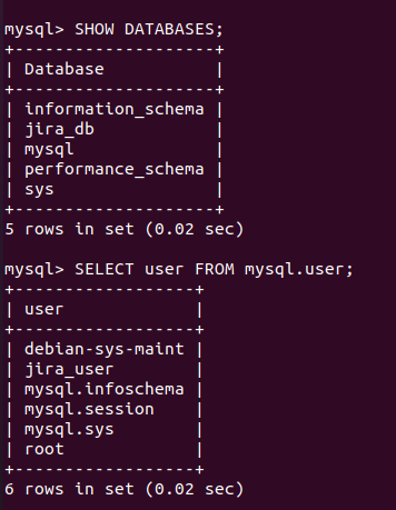

jira-error.pngThe Database jira_db, as well as the user jira_user exists in the Database.
Where can the error lie? And what is the Error (null)?
