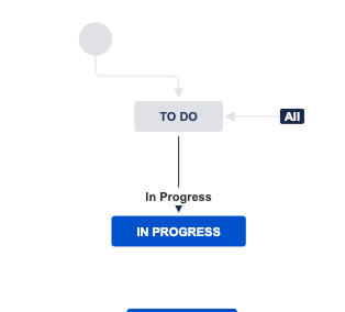

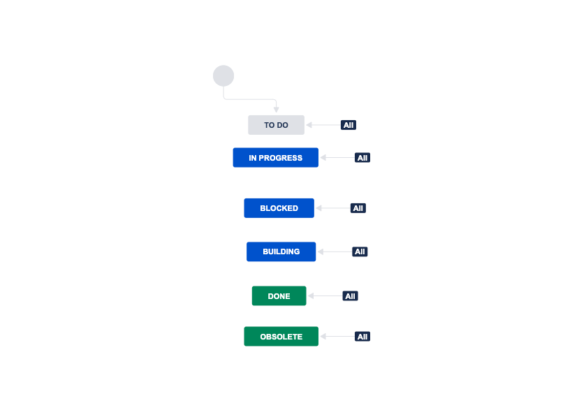

Typically in the default workflow issues are allowed to transition from any status to any status. That is designated by the "All ...> " symbols you see pointing to each Status in the workflow diagram. Here's an example
These means an issue in any status (represented by "All") can transition/change status to (represented by the arrow) to the specified destination status. An issue in any status can be changed to the In Progress status, for example.
If you want to restrict the statuses an issue can be moved to/from you have to remove the existing "All ---> " transitions and add new transitions.
In this example I want the users to be able to transition to the In Progress status only if they are currently in the To Do status. So I removed the "All --->" that pointed to In Progress, and added a transition from To Do to In Progress.

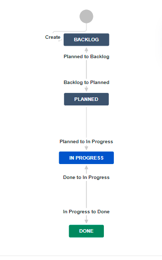

I loved the way you explained the workflow and their transitions by providing examples. In my current organization, I do have the JIRA administrator permissions. Following your example, I was able to create transitions and removed "All" by editing the workflow. However, when I published my Workflow after adding transitions and later tested it. I couldn't move any tickets on the board. Please let me know if I am missing anything here? Below are the transitions I have created
Backlog - "Backlog to To Do"
To Do - "To Do to In-Progress"
In-Progress - "In-Progress to Done"
Done - "Done to In-Progress
Can you show us an image of the diagram image for your workflow?

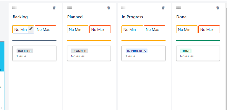

Can you show us an image of the Columns page from your Board Settings, showing the mappings of columns to statuses?

Attached is the workflow diagram with transitions and columns screenshot. Please note, I created a testing project and shared the exact workflow that we have designed on our project. Unfortunately, I wouldn't be able to share the project details due to privacy and security issues.
Scenario: Ticket is in the backlog and would like to move to To Do and so on (i.e. from To Do to In Progress and Done). Unfortunately, I cannot move the ticket from One column to another. Do I need to say "yes" to save a copy when publishing the workflow and do I have to select a screen as well? Please advise
When you look at your Project Settings and select Summary, can you confirm that what it shows under Workflows is the name for the Workflow Scheme you expect for this test project, and that below that it lists the workflow(s) that contain the changes you made as shown in the workflow diagram in your previous post.
Looking just at the images you posted, you should be able to move the issues.
You have to make sure that the workflow you created is part of the Workflow Scheme that you have associated to the project. Also, within that workflow scheme, the workflow you created has to be associated with the issue type of the issue you are trying to transition. Workflow Schemes can contain multiple workflows, each applying to different types of issues in a project.
