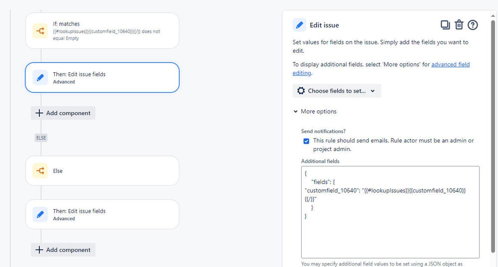

Hello Bill.
The automation I'm trying to do is exactly what I posted below. I want to set a data type field same as the one found in the lookup issue. I made sure only one is returned (used the lookupIssues.size.
That is exactly my issue. conditional logic does not work in the advanced field edit.

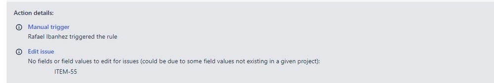

The test below did not work, Does not matter what I put on the Summary, the line is always skipped.
"fields": {
{{#if(equals(issue.Summary, "TEST"))}}"customfield_10640":null{{/}}
Here is the message LOG
