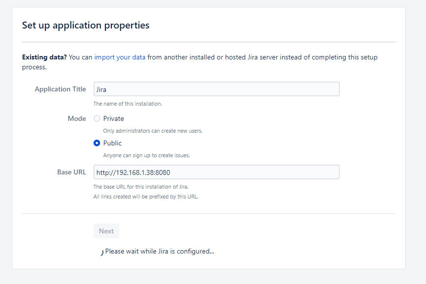

I use sql server 2016 and follow the documentation for this. Jira Configuration Tool indicates that Connection Successful, but Jira can not proceed to next step. I used Jira for a while with H2 database in same environment and i wanted to use Ms sql instead of H2. I created a database for this, i can ignore old data so i don't need to immigrate from H2 to Ms Sql.
I created a database and try to connect it to Jira.

Could you describe "can not proceed to next step"?  What is the error message or behaviour?

You can see the screen attached. It keeps this screen for hours without error.

That step does take a while, but if it goes over 10 minutes, it's likely to be having a problem.
You'll need to read the application log to find out where it is stuck.

Here is the atlassian-jira logs when it tries to pass this step. I couldn't understand what the problem is.

That looks like a healthy log that should have moved on.
If it's still stuck, then there's probably just a timeout.  Try refreshing the web page first, then try a new browser window where you go to the base url for it - the install should pick up where it left off, unless it's actually complete and able to serve the application.
