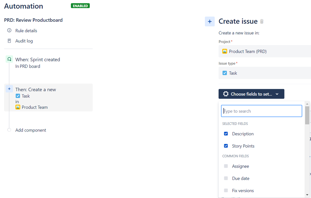

We have a few recurring tasks that we'd like to complete each Sprint, and it'd be great to assign Story Points automatically. I've found the options within automation, but I get an error when the rule runs - can anyone help?
Here is the rule:
Here is the Story Points section of the rule:

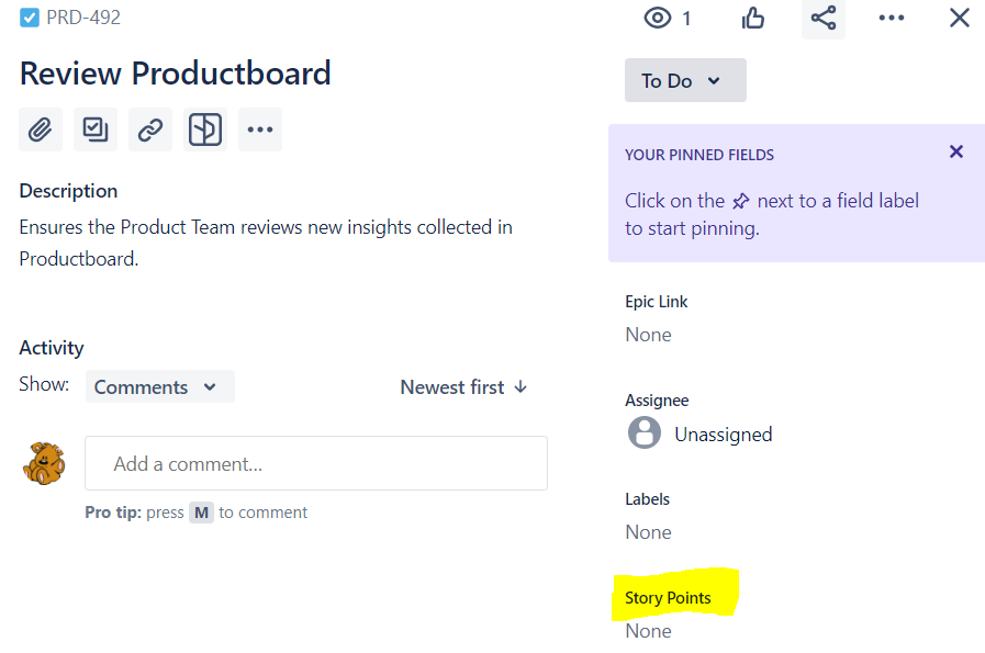

Here is the created issue:

Hi @Trudy Claspill thank you so much for your suggestion. Sadly, the 'story points' field is already available on the 'create issue' screen as per below:
@Bill Sheboy (and Trudy), to confirm, this is a Company Managed Project, so Story Points is the required field (and not Story Point Estimate) - but thanks for the pointer!

Just a hunch here: during your task create in the rule, are you using the field drop-down to set field values *and* using the More Options with JSON, as that is what your image appears to show.
If you are not using the More Options, please clear that out (setting it back to the default), collapse the More Options section, and then try it again.
__Bill
Sarah Baker
June 7, 2021
Hi @Bill Sheboy
I am using 'more options', but not for story points - the additional fields box has been used to add the newly created issue to the sprint that's just been created and triggered the rule:
