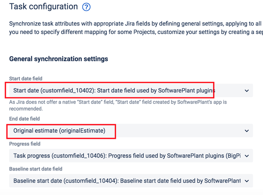

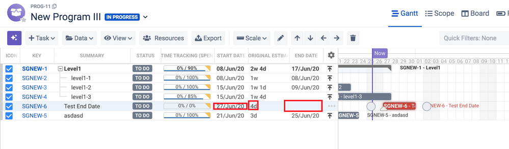

I use the Start Date field as the start date and the original estimate as End Date in BigPicture configuration. The big picture automatically calculates the end date in GantView, and I can see it there. I want to save the end date to Jira issue to able to see it when opening the issue. Is it possible now?
Ansar Rezaei
June 25, 2020
Here a screenshot of it. Any suggestions will be appreciated.

Please excuse me - the information provided in my last response was incorrect. I confused the configuration for my tests which caused faulty results and findings. The correct info is as follows:
When mapping End Date to Original Estimate, the field End Date in BigPicture remains empty, as depicted in the screenshot in your message. Hence, no data is synchronized to Jira.
The good news is, though, that the upcoming version of the plugin - BigPicture 8 - will provide an additional End Date column which allows having end date displayed in the Gantt chart, even when it is mapped to Jira's Original Estimate. Please note that in such a case, it WILL NOT be possible to synchronize this value to Jira. Such an improvement is planned for future releases of BigPicture 8; however, no timelines are available at the moment.
