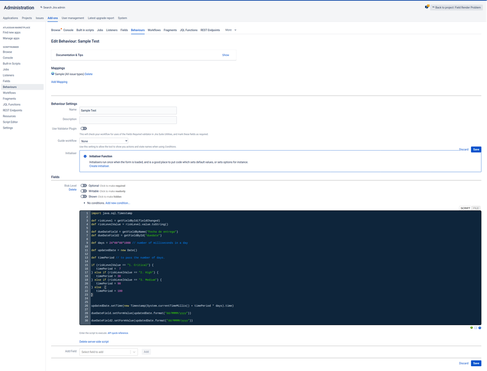

Below is a print screen of the same Server Side Behaviour configuration:-
Below is a sample code for your reference:-
