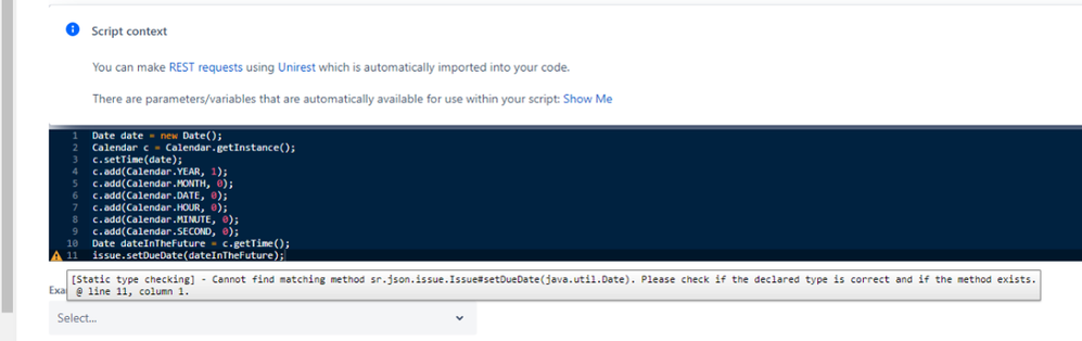

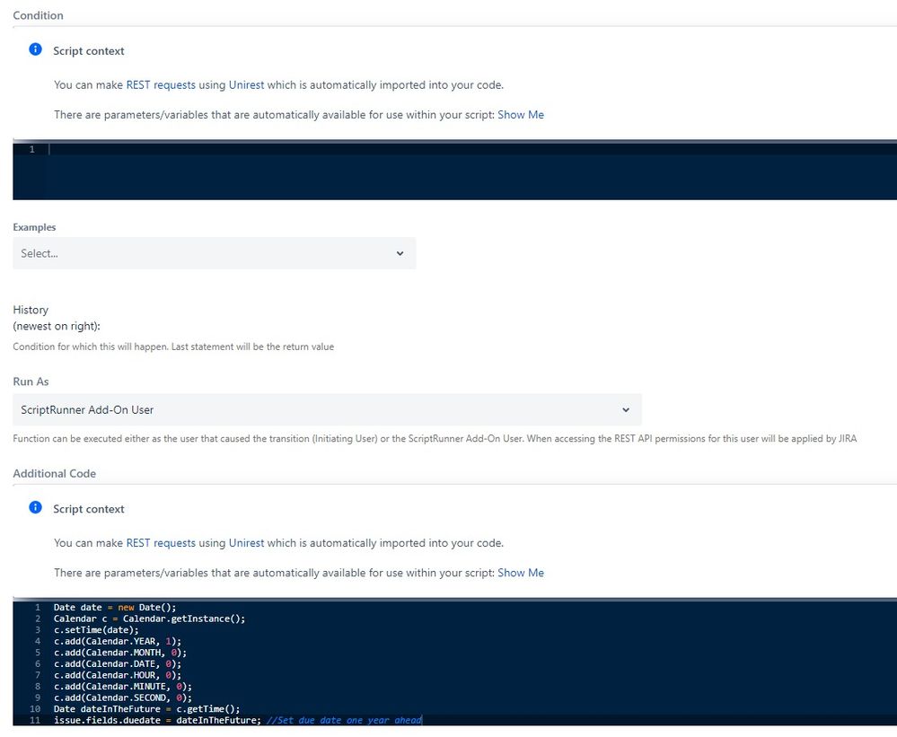

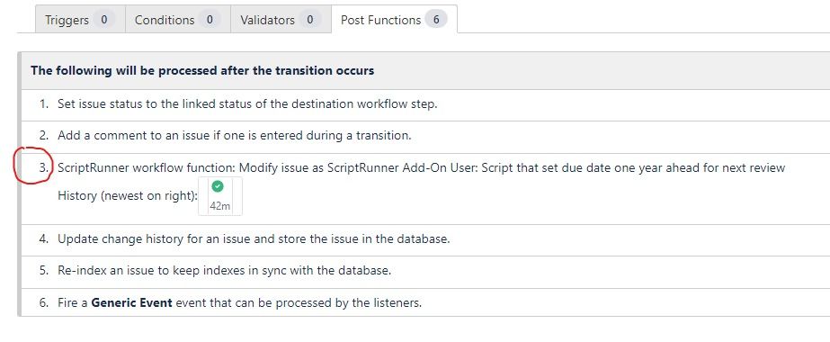

I am trying to update due date for an issue on a specific transition using post function and Scriptrunner. I have the below code wish is accepted and executed ok. However nothing happens with the Due date field. I am new to this and having a hard time navigating the documentation around it. I have read different posts on the subject and by that collected the code below. Any ideas on what I am doing wrong?
Date date = new Date();
Calendar c = Calendar.getInstance();
c.setTime(date);
c.add(Calendar.YEAR, 1);
c.add(Calendar.MONTH, 0);
c.add(Calendar.DATE, 0);
c.add(Calendar.HOUR, 0);
c.add(Calendar.MINUTE, 0);
c.add(Calendar.SECOND, 0);
Date dateInTheFuture = c.getTime();
issue.fields.duedate = dateInTheFuture;

I have tried that but the function setDueDate is not recognized.
I also just tried your last two lines
def today = new java.sql.Timestamp(new Date().getTime())
issue.setDueDate(today)
but it yields the same result.

make sure you're casting your issue to a MutableIssue type -
try something like this:
import com.atlassian.jira.issue.MutableIssue
date dateInTheFuture = c.getTime()
def myIssue = issue as MutableIssue
myIssue.setDueDate(date)
