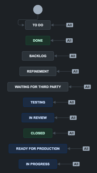

I have a Simplified Workflow configured for my project. By configuring the project board, I've ended up with the following workflow:
As you can see from the workflow, when I create an issue in this project at the moment, it sets the status to "TO DO" by default.

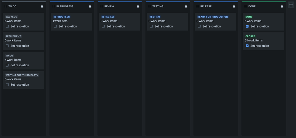

I want to change this so that the Backlog is the default status. I had hoped that rearranging the columns so that Backlog was at the top would solve this issue but this hasn't seemed to work.
I've had a search on a few pages (e.g., Using the Simplified Workflow and Configuring columns) and can't see anything obvious about how to change this.
Please see my board column configuration below in case that's of any use.

You'll need to change the workflow, the order of the status on the board doesn't affect what status the ticket goes to. You have to move the first arrow that goes to To Do so it goes to Backlog, that first arrow is what set the first status of the ticket.

Hi Ana,
While I could do this, the workflow has the following description on it:
Software Simplified Workflow for Project {ID}
Generated by JIRA Software version 1001.0.0-SNAPSHOT. This workflow is managed internally by Jira. Do not manually modify this workflow.
Making changes to the Jira board will update the workflow automatically so I'm concerned that editing the board manually like this will be overwritten in future.

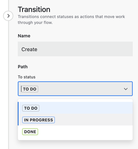

Based on your description it sounds like you are using a team-managed project since the workflow was updated by changing the board. If that is the case then from the board, click on the three dot menu up in the right-hand corner and select Manage workflow. Next click on the Create transition and change the path to Backlog.

Thanks for your response. Unfortunately, the project is company-managed not team-managed. Hitting the three dots on the board only gives me the following options:
  • Configure board
  • Create board
I'm still pretty stuck as to how I can achieve this since I'm discouraged from editing the workflow manually since, as you say, it's updated automatically depending on changes to the board, and has the following description on it:

If it is a company-managed project then you have to make the change from the workflow, and you can ignore the description of the workflow. That description is autogenerated and you can always make a copy of the workflow and associated that with your project.
