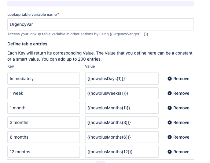

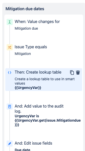

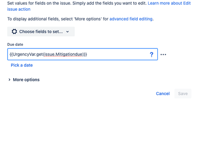

Hello,
More questions on automation lookup tables.
I am trying to create an automation that sets a due date based on a custom field duration chosen by the user.  The custom field is a single choice selector, and here is the automation I have so far.
Screenshot 2023-09-19 at 10.53.28.pngScreenshot 2023-09-19 at 10.53.37.pngThe audit log says that the get command isn't actually pulling anything, so there's something in the syntax I obviously don't understand.
Any help you could provide would be great, thank you!

Hi @Lana Kelly ,
A couple of things I notce without actually running the rule:
  1. You need to call on your select field like this:
    {{issue.fields.Mitigation due}} -> use the actual name with spaces and all
  2. Your value is composed wrong:
    {{now.plusDays(1)}} -> do not forget the "."
Please try these adjustments, it should work then.

Lana Kelly
September 19, 2023
Hi @Piet Pieters
Thanks so much for your help.  I had originally had the . but didn't have the space for the field part.  It worked perfectly once I added that.  Thank you!
It's so confusing, because some fields don't have the spaces (affectedVersion and dueDate, for example), so I was going off the documentation I could find.  Thank you again for your help!

Piet Pieters
September 19, 2023
Hi @Lana Kelly ,
those are jira fields (not custom fields), they often have a different notation, it is indeed confusing!

Bill Sheboy
September 19, 2023
Hi @Lana Kelly
Yes, and...to Tessa's answer:
Smart values are name, spacing, and case-sensitive, and so it can sometimes be unclear what to use in rules for a field.  To find the smart value for a field, and if it is supported by rules, this how-to article can help.  Essentially you find an example issue with your field, call a REST API function with a browser, and then search for your field to find the smart value.
https://support.atlassian.com/cloud-automation/docs/find-the-smart-value-for-a-field/
