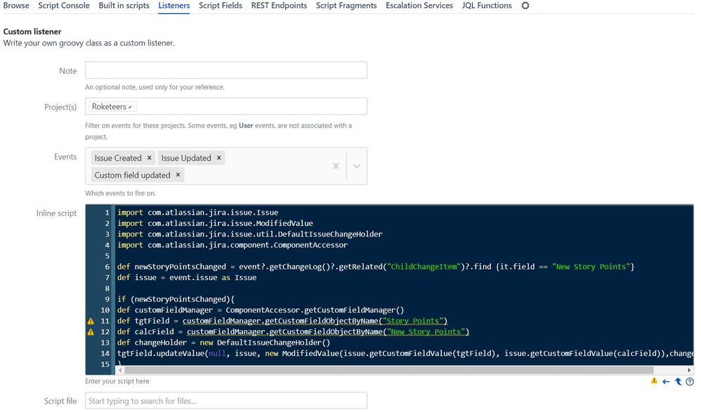

Hello @Antoine Berry ,
Thank you for your answer.
Since i am really new to ScriptRunner (i just installed the trial) - i might miss something obvious for you, but the Script doesnt work. (all i've done is covered within the Screenshot).
Just nothing happens. -> Do i miss something like any project configuration?
i tried the exat same code from you - without an declaratiion of issue as an event object, i got an error message, so i added this declaration again.
Hi @Peter ,
Everything looks fine ! We might need to some debugging then. Can you confirm that "New Story Points" is exactly the name of the custom field, and that it is a Number field ?
Also, you do not need to redefine issue. Please update the script as :
