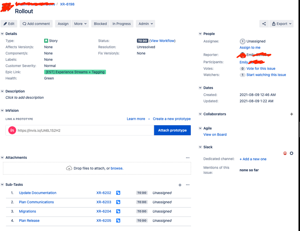

Each of the Issues in epic (Define Requirements, Solutions Analysis, Implementation, and Rollout) have their own set of sub-tasks which are also auto-generated via post-functions set in workflows unique to each issue type. For example, Rollout:

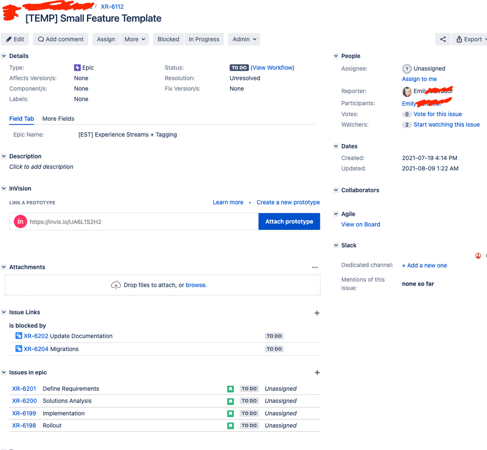

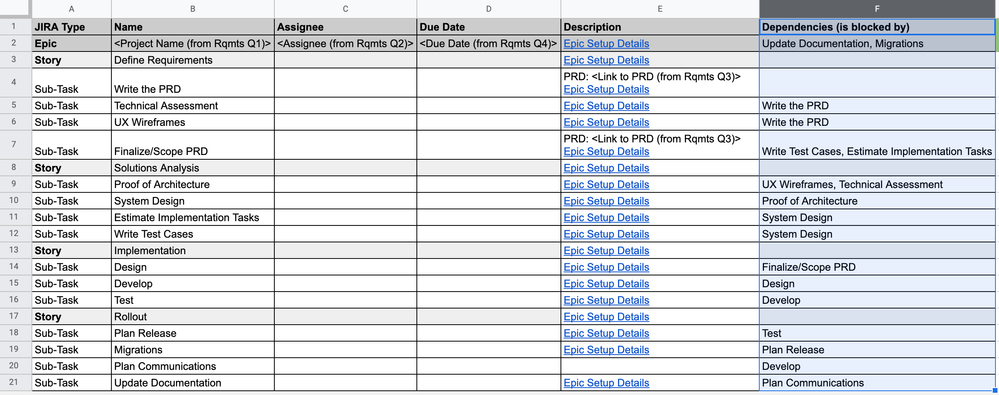

Almost all the issues created have linked issue dependencies:
This is where I'm stuck. I'm not exactly sure how to set the 'Linked Issues' field to direct to issues that aren't directly involved in the automation. For instance, I have a 'Create / Clone Issue(s) Post-function' set in the create transition for the Rollout workflow that's responsible for creating the Update Documentation Sub-task nested under Rollout:
In Groovy, what expression would work to set a "blocks" link to the parent issue's epic, as well as a "is blocked by" link to a separate sub-task nested in the parent issue called Plan Communications?
