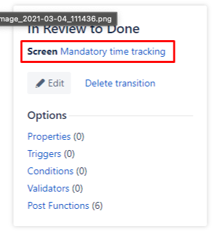

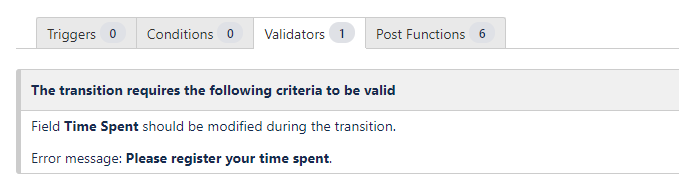

Create a validator "field required" or "field value changed" for Log Work field, since this validation happens during a transition, you need to register that change during, not before.
For that you can Edit the transition with that validator and add a screen with the Log Work field on it. I would create a separate screen for just this transition only.
To make it mandatory make sure to have the field Log Work required in the Field Configuration used on the project.
