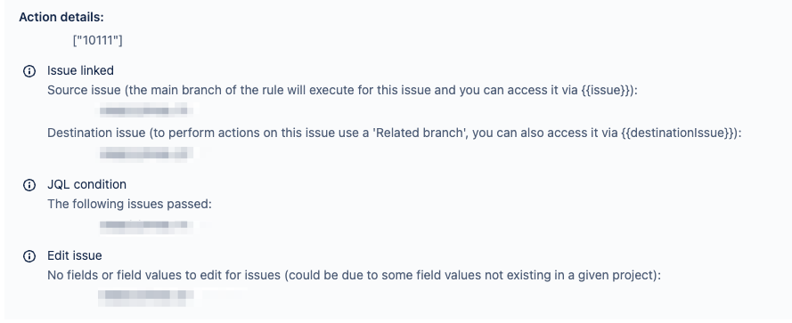

I'm sure this could be achieved through simple automation, but when I look at my audit logs the trigger issue is the created Test. Which isn't an issue until I try to get the Epic Link of the "tests" which I can't figure out how to get.
I've added a ss of my audit log because I've been continuously tweaking my trigger conditions and I'm getting the same result. Any ideas on how I can achieve the above? Thank you!

Hi @Kelly McAteer - Your rule would look something like this:
  • TRIGGER: Issue Linked (Is Tested By/Tests)
  • ACTION: Edit Issue (Epic LInk)
    • {{destinationIssue.Epic Link}}
How this works...  In the Issue Linked trigger, you get the following information:
Rule executes when an issue is linked to another issue. {{issue}} will always refer to the source issue, so if ISSUE-A is blocked by ISSUE-B, this rule will execute on ISSUE-B. To access ISSUE-A, use {{destinationIssue}}, and to access the link type, use {{linkType}} (e.g. {{linkType}}
In your case, you would substitute blocked by for is tested by where your Task would take the role of {{destinationIssue}} and your Test would take the role of {{issue}}.  So, as you pointed out, the rule executes against the Test, so you just need to make a call on the {{destinationIssue}} to pull information from the Test.
